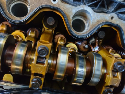

Number 7 miss is often a tossed rocker. I wasted a lot of time checking many things before I found it is a common problem. The pic is of my 2011 Expy. Rocker was $14 and gasket set was $54 a year ago. I think I gave $35 for a Ford valve spring compression tool set. I was fortunate that the rocker found a solid perch and did no further damage. There is a very good mechanic on YouTube that works on Fords. His videos are very well made. I only replaced the single rocker, which may be bad practice, but I have 50,000 miles since it was done with no hiccups. If this is your issue, check the cam lobe very carefully for scoring, as well as look around for other physical damage. I'll add one caution. The back screws on the rocker cover can be a booger to get to without exactly the right tools. I used a 1/4" drive with a swivel extension.
