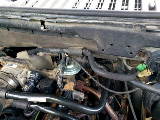

Hey y'all, what is this hose from the throttle body housing, connected to the green adapter on the right? 2004 5.4 2V.
Part #? Name?
It's soft enough for me to put a finger through.
Safe Travels,
Peter

It's a vacuum hose, you can replace the hose section with any suitable vacuum hose.

Peter and @FlyBry , @Hamfisted posted an Amazon link for the "Fuel Vapour Separator Tube." Get it there or Parts.Ford.Com, which indicates $48 (price varies a little depending on which dealership you select) and Free shipping. Part # 9D289. I tried to post a link below.
Mine looks just as trashed as yours so don't feel bad. Good luck
