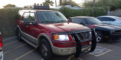

Now that its solid, i began the modding and ill keep it short, this is what i did.

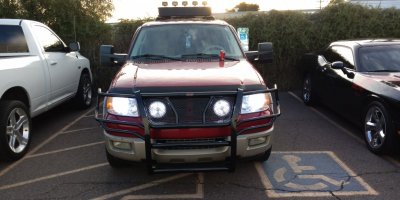

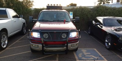

Ford Roof Rack Cross Bars (they were missing)
Extended Full Length Roof Rack from Amazon
5 x 2.5" LED Pods (Mounted forward on the roof rack as offroad lights)
2 x 8" LED Bars (Mounted rear on the roof rack as offroad/backup lights)
2 x 7" Sealed Beam Buckets in the Grille with LED 90w headlight bulbs
3 x 3Amp Dual USB Charger inserts (front & middle row, and back cargo area)
1 x 3Amp Dual USB Power port replacement socket (cut a hole, and installed for 3rd row)

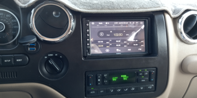

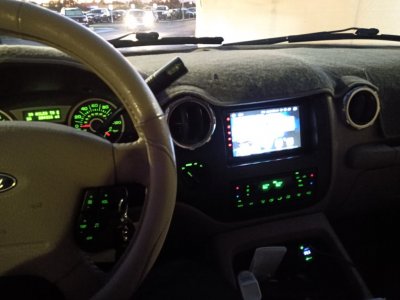

Android 8, 7" Head Unit (Quad Core, 4GB RAM)
USB Surface mount extension (on dash, exposes Head unit rear USBs to dash use, flash drives, etc)
Pilot Auto Wireless Remote Relay Controller (Controls all the additional lights i added)

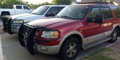

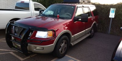

Frontier Truck 200-10-3004 Heavy Duty Steel Grille Guard/Push Bumper
Trail Ridge Tow Mirrors (Power, Turn Signal, Puddle, Memory, Telescoping, etc)
The push bumper is fantastic, Very thick steel compared to others ive seen, and mounts to 6 points on the frame, We stood and hopped on it and it didnt move at all. We got it here:
https://bumpersuperstore.com/i-1145...4-grille-guard-ford-expedition-2003-2006.html
I had Audio Express run a 4 conductor cable up the front pillar to the roof to provide power and connectivity for the offroad lights, and mounted the controller on the roof rack up high so i can control the lights from extreme distances away from the truck if needed, it goes through the roof with a waterproof trailer plug so i can easily unplug and remove the rack if needed. It almost looks factory esque, they may not always do things properly on their own, but audio express seem to be awesome at following directions if you tell them exactly what you want, with a drawn up plan.
The rear diff had a small leak i discovered, so i had a shop ive used for my mustang diff swaps fully rebuilt the 9.75" pumpkin case of the expeditions IRS rear, bearings, seals, the works. Front diff checked out fine. This was when I learned it was a heavy towing edition, the ordered the parts for a standard and nothing was right, hehe... 4x4 and heavy towing package, SCORE!!!!!
We tore through California on I-8 even during a big wind and rain storm at 85-90 from arizona to san diego and onto base at NAS North Island, one of our required stops, on a single tank with some to spare. Truck did perfectly and the Vaca went without a hitch.
