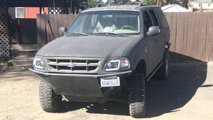

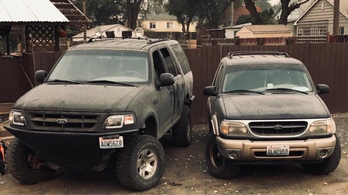

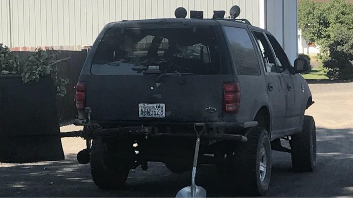

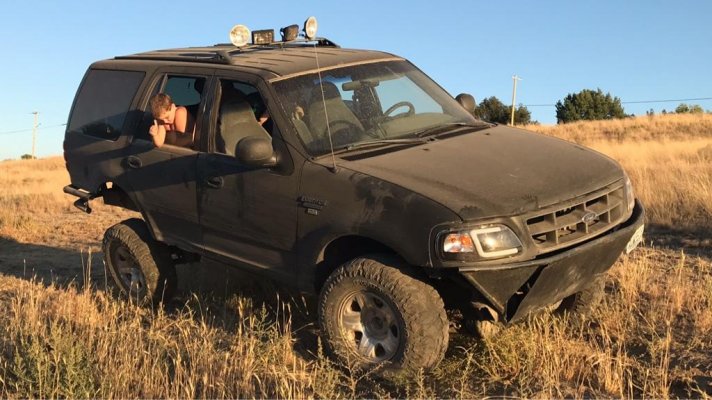

Getting this started quickly. I will reply more in depth this evening when I have more time. Building 8b5491e0c767726c480a504929055464.jpg
a 98 XLT, mostly with scrap metal and my welder, tho I have bought a couple items I’m not able to build.. I will get into mods, as well as future plans for the near future.. Just a picture or 2 for now.. fb36667c6ab6082fb74ebcffb402bc22.jpg

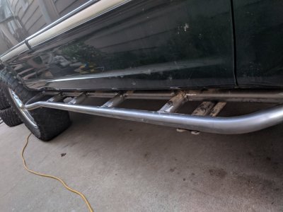

Time to throw down some info.

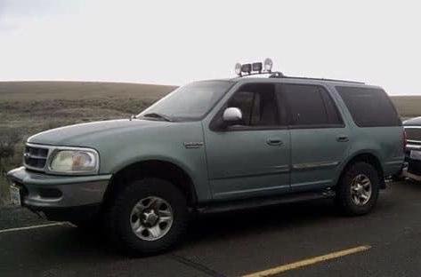

Bought my 98 totally stock. Bought 31” tires on the way home. Put some lights on too, and thought I was badass.. oops.. Had no idea how wrong I was.. bought another for parts..

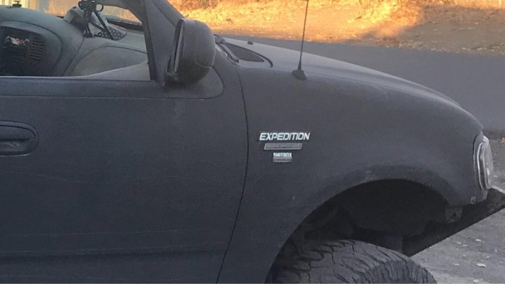

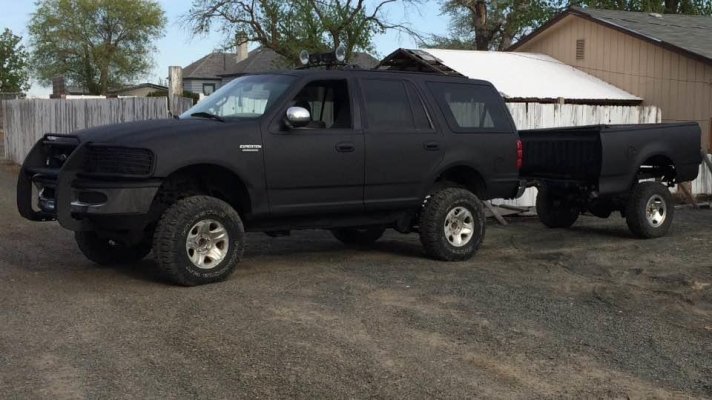

Fast forward too now. Posi front and rear.. I have 3” suspension lift via rear blocks and torsion bar raised in front. Also have 3” body lift.. Ran into the all known cv angle issues soon as I raised the torsion bars. Constantly pulling shafts apart instead of breaking them. Recently dropped the diff 2” and haven’t had a chance to play with the results yet. Currently sitting on worn out 33” Milestar Patagonia’s and getting ready to swap in some 35” federal couragias..

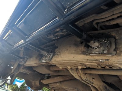

Front and rear bumpers are homemade, removing 1 foot of frame rail up front and installing a redneck skid plate bumper.. Solid as f*#k.. Cut the rear quarters up 10 inches from the lowest point, had to cut and relocate a few body support sections, and built the rear bumper to hug the truck as tight as possible. Equally as solid as the front.
Motor is stock, with the addition of short tube headers, removed the second cat from each side, and installed a fireball racing muffler.. I like loud.. Gotts mod is the only other change to the motor. No tune as of yet..
Still running stock 3.31 ring and pinion, on the list are 4.88.. Should be sometime in the coming spring. That list also includes winch and receiver cradle.
Currently in the process of changing torsion bars, swapping to the air suspension model torsion bar, as I’ve gotten recent info to indicate it is softer than the standard suspension torsion bar. Both sway bars have been deleted.

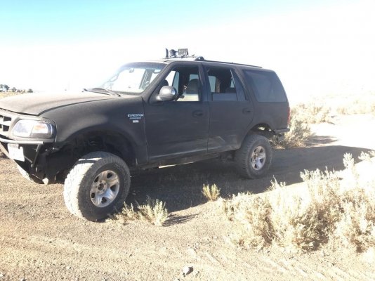

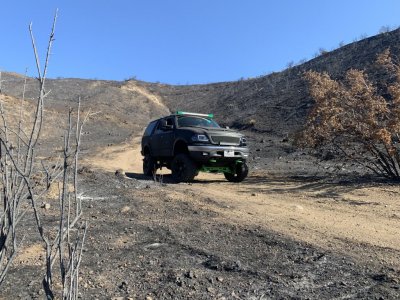

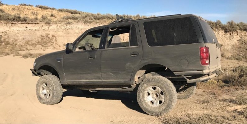

Dealing with lung disease for a number of years, Moab has been at the top of my bucket list. My plan is to make it happen sometime fall of 2022, before the option is off the table2ee3935b7e54a3d5c64526ce0591d056.jpg
.. It takes time, and a toll on myself, but this truck will be ready and up to my expectations by then. Will update as the project continues. Go ahead and tell me I can’t wheel Moab in an expedition, everyone has. That’s the exact reason it’s going to happen. I’ve done everything with this truck I was told I couldn’t, and I don’t plan to stop now.. 66a05dbec59e146cd452fea6670993b8.jpg

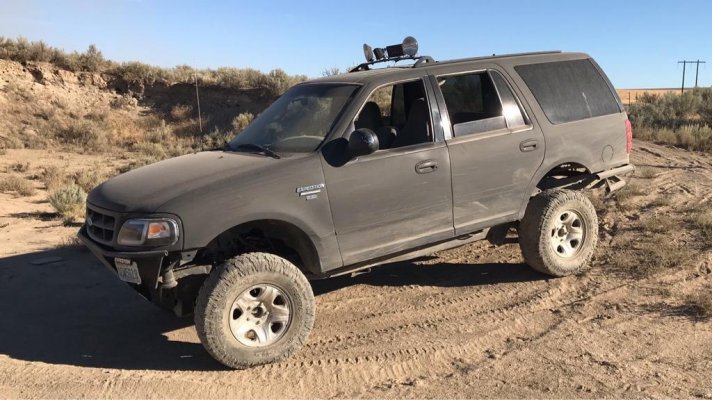

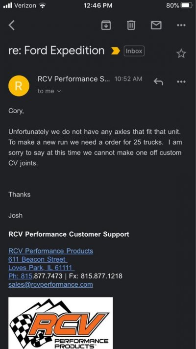

Got in contact with RCV yesterday, they responded today. Far as I’m concerned, as a wheeler, weakest link hands down..
Doing work today. Cleanin up the yard, had some pretty good windstorms tearing apart trees.. 9ef466bf4c91369b457c50fb842d28c3.jpg
