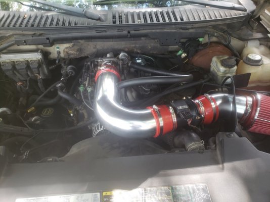

look into "gotts mod" in the search...cheaper to build ur own intake then to pay hundreds when gains are minimum in comparison of intakes...your BIGGEST BANG will be a programmer then exhaust...i went from 17 to 24 mpg hwy with installing K&N CAI...single swept side catback flowmaster 40 exhaust (upgraded to catback duals w/flowmaster 40s)...and superchips vortex 1950 programmer w/gas saver setting installed...you'll see a big difference there...next is removing the clutch fan and doing electric dual fans which will help as well
