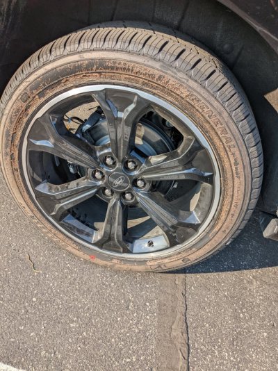

446 miles on the odometer, and i'm now on my second set of tires, plus one that was bad from the second batch. For those keeping track, that's 4 original, 5 new (1 was bad).
Drove the tech myself today, he was a great guy, immediately saw what I was saying about the wheel vibration. I also noticed when the lane centering was off, the car drifted to the right, so he suggested alignment was off.
2 hours later, he said the tires (road forced) were technically "within spec" but not great. He suggested getting 4 new ones from Michelin or some better brand. The Generals seem to have crappy quality control. Alignment was off, toe on both front and rear was "just shy of the red" but combined it was off enough to feel it. So alignment is now "green", truck tracks straight, but still have some subtle vibration above 65.
Next stop, new tires, if this doesn't work we have to pull ford's regional techs to take a look. The tech thinks new tires will help, one wheel has 7.5oz of weights, which he said is excessive, but possible for a 22" wheel. He feels a better tire brand would drop that weight substantially.
