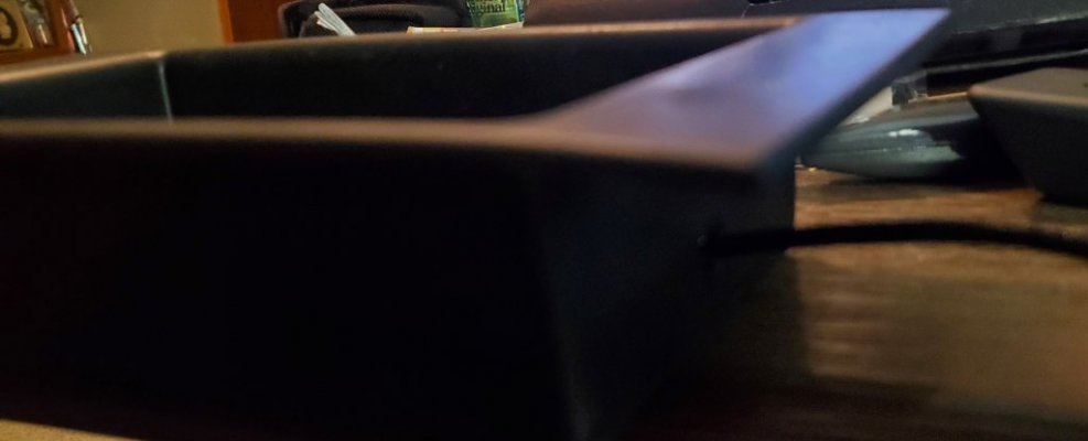

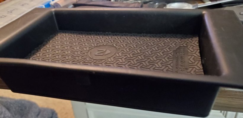

I just added wireless charging to my 2017 ford Expedition Platinum. I used a kit from BrandMotion FDMC-1310 and installed it in the tray in front of shifter. I have attached pics, and it comes with wire harness. It has OEM look when installed, QI compatible, and 15W power, 3 coils.

Yes you have to trim to fit, they include a template out of heavy stock paper cut it, and then use on the rubber pad and the substrate to get correct size. You can run power any where you desire, I am going to run it to the fuse box on passenger side kick panel and tap off a fuse. Only change I would make is when drilling hole into rubber tray I would drill closer to bottom of tray instead of in the middle. Although, you can't see it when installed. I will post more pictures when I install it, just waiting for warmer weather. Wiring harness has a fuse installed already.

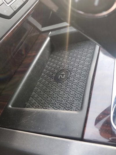

Here is the final results installed. I used an ATM fuse tap to fit the fuse box, I believe fuse #47 which is not used but had a 5 amp fuse installed, switched to ignition. Works great, and like it came from the factory that way. I would recommend installing wiring first, so that you can just plug it in when you install.
