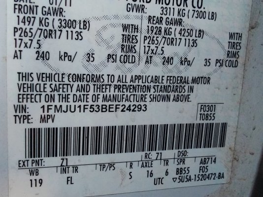

Thanks GlennSullivan. I checked out the door code and it's axle 16 which indicates an open diff with gear ratio of 3.73. I've attached a photo of the door jamb codes.
How do I identify whether it has the higher output alternator? As for HD tow, I was under the impression that if the factory tow hitch has both the 4 prong and 7 pin connectors, it has the HD tow package. If it has just the 4 prong, then it it is not HD tow package. It has only the 4 prong and I do not see any wiring or evidence indicating a 7 pin connector existed.

Looks like for this model year, I was wrong on all counts. I specifically remember being pissed off that I could not order an expedition with LSD, but the Only Way the SSV model could be ordered was with LSD. And also wrong about the alternator and HD cooling for the 11.

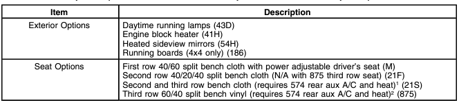

See the details of your 2011 SSV in the attached document, again sorry for the mis-information.

Thanks for your help Glenn, that document is amazing and I've saved it! Nice to see a very straightforward listing of different packages available. From there I am able to determine I have the 52C package (XLT comfort group) and 17T (technical package). This is interesting because the vin lists it as a base XL.

The HD radiator comes from the HD tow package. Not part of the base SSV package, which surprised the hell out of me. The OP does not have HD Tow.
