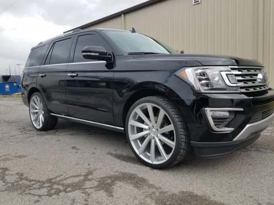

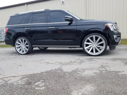

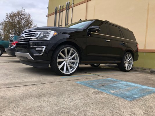

Just put 26’s on my 2018 ... wanted to post here since there isn’t much out there that I saw during my window shopping phase
What specs for wheels offset and wheel size
And side if tires

you can do +10mm to +40mm 26x9.5 to 26x10 on295/30/25...i like 305/30/26 but they dont go on 9.5s easily
