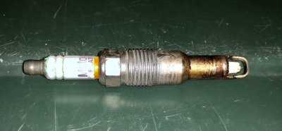

2007 Expedition EL 2WD with only 348K miles.
Around 6,000 miles ago new spark plugs and coil packs were installed. Yesterday the idle and ride got very rough - bad shaking and significant loss of accelerating power. Check engine light started flashing and then solid. Went to Autozone for diagnosis which determined a misfire in cylinder 1 - in hindsight probably the best cylinder to have an issue.
Pulled the coil pack and then removed the spark plug; the plug was so heavily corroded and the worker said the plug was “f’ed”. Replaced the plug and driving is back to normal.
Obviously this is concerning that a new plug would be in this condition only a few thousand miles after install.
What could have caused this?

Where's the corrosion? Looks to me like there's just some burnt brownish carbon deposits on it.
All plugs you pull out of an engine will have brownish deposits on them (caked in burnt gas + a bit of burnt oil that gets through piston rings). Your old spark plug looks fine externally, it's more than likely your plug coil that was causing the misfire...
Here is a used / new spark plug comparison from when I did mine a few weeks ago :

Ran the scan tool and got these pending codes: P0354 (coil D) and P0358 (coil H). So to 762mm’s point, could the new coils be causing an issue not related to how the spark plug looked?

That plug looks fine and normal.The brown area is where the carbon builds up as part of the poor design ford did and what causes them to stick and when they were 2-piece, leave the bottom half stuck in head.
But that should not be causing the misfire.
P0354 very well might be a coil fault.
Normally is the coils are good and a plug is misfiring or even if a coil is breaking down you will get a P0304 for #4 and them sometimes you will get an 0354 or other generic misfire code along with it.
