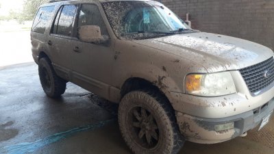

Bumping this post, planning on putting big ol' tires on my '04 eventually and would like to know a cheap method too. Anyone know if you can do it via one of those scanner tools? Was considering buying one of those "universal" ones that works on multiple brands, but not sure it'll be worth the expense

Hi Randy, As of my last checkup I can tell that FORScan is a viable option to changing tire sizes as long as you have the right mod information. You can always get a Chinese versions of FORD VCM adapter (there are many). Many had reported success with those using IDS. VXDIAG has a software version of it (VCXNANO) All that said these two solutions can be highly risky if you don't know what you doing and possibly brick your module. There are dedicated forums where many have prior experience and are happy to help. FORScan would run you around $50 with a really good adapter. VCX NANO will run around $100 and long delivery date. Good Luck

Hey Randy. Sorry about the confusion. In order to change the tire size properly there is a need for the right software (FORScan, IDS) and the right Hardware (VCXNANO, OBD R/W capable), one that is able to communicate back and forward with the ability to modify some data on the vehicle Modules. With Advancetrac its quite a must since the system is so embedded in many parts of the car and this data is relevant in the way it calculates the response when emergency happens. I dont believe nor I have yet to see any product on the marked that is a plug and play "chip" since one have to modify data in the relevant modules. If any -- a good way to go at it with no messing around is to find a dealership and pay the time it takes them to reprogram the right modules to the right tire size. With the dealership level computer that should not take more than an hourly rate. I hope that helps. Good luck (and i hope you understood more than that this time.) Unfortunately it seems like the Expy community is not as big as others (the f-150 especially) on mods and tweaks in that level so information is hard to find.
