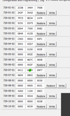

I did it with forscan. BCM human readable (non-HEX 0x) its one of the options there. When I did the IPC hex mod I had a trailer brake controller error put up (I don't have a brake ctrl), I then used forscan under the BCM human readable module to disable the brake controller. This is also where I found a way to make this mod w/o using the hex version.
^stock value b4 mod^
