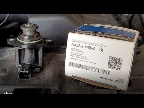

I know my previous response wasn't very helpful, lol. Maybe smoke test the system for leaks? I'm guessing the pressure release solenoid on the CAC because this sounds like a noise a blow-off valve would make. The rubber seal on those valves is known for tearing. Does the sound vary by acceleration rate? If you're accelerating quickly vs slowly, does the pitch or likelihood of hearing the noise change? That might provide a clue. Here's a video about the part:

RPM correlates with speed and gear, not throttle position. Try using a manual mode on the transmission so you can lock the RPM, then see if you can get the noise. It sounds like charge air is venting someplace when the throttle body slams shut.

I will be looking into the blow off valve and CAC. JasonH, thanks for the video link.
