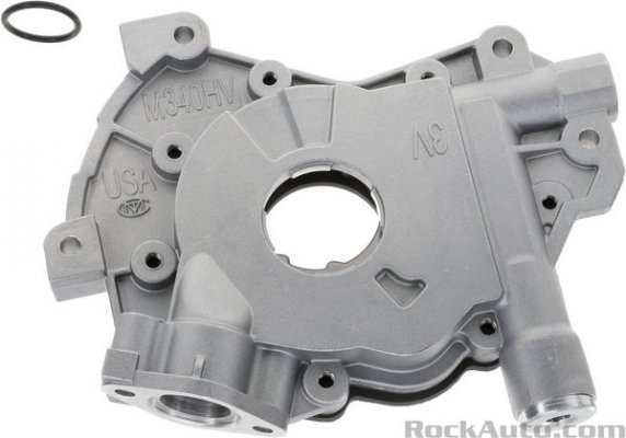

I've got a 5.4 3v here that previous owner attempted to fix with no name parts. Parts failed, poo got in the oil, motor is toast. What was a failed tensioner is now a full rebuild.
I have a shop full of aftermarket stuff, but all the 5.4's get only OEM timing components. Oil system gets a Melling pump.
For the labor it takes to get to these parts, and considering the potential catastrophic damage that bad parts could cause, I will not take a chance with bargain parts.
