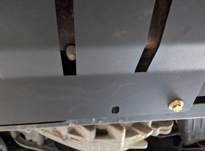

Oh, I forgot to mention that RCI skid plates don't have the one for the fuel tank. I heard yesterday the expedition also came in the ssv (police) and had full skid plates. If true, nobody else does fuel tank skids and that might be an option. I'm slowly building up my rig. A lot of the parts acquisition is some fabrication too. The RCI skids don't fully bolt on w/o issues since they are for the f150 but happen to have similar mounts. There are cutouts for the exhaust but it will still clang unless you have a couple thick washers at the rear of the transmission skid.

I'll look into possibly my motor mounts going bad then. If I don't have those washers it rests on the exhaust. Currently it does a single clang upon startup .

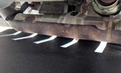

Looking at photos on RCI's website, it looks like the transfer case skid plate may not fit because it appears Expeditions have an additional cross-member just behind the transfer case that the F-150's do not have (or have in a very different position). This also means that the transfer case might be less susceptible to damage since it sits between the 2 cross members that jut downward. This is also my greatest concern when it comes to breakover angle for our Expeditions as it juts down pretty far in exactly the wrong place.
Here's a photo under my 2017 EL 4WD with the "extra" cross member in the center of the photo. That's the one I don't see on the F-150's.

For gas tank skids, I'm thinking about fabricating one myself (and use the SSV straps - thanks @Black for the part #'s). The design looks like we would just need to be able to cut, bend, and drill through thick plate steel.
There are two things I would be mindful of when fabricating my own.
1st being weight since the straps are already supporting 33 gallons of gas or about 200 pounds.
We’re talking a pretty big steel plate so all that weight will be held by the straps as well.
Gas tank straps tend to be fairly thin. And certainly not as strong as bolting to the frame like most skid plates. I would go as thin as possible for my steel or use aluminum.
2nd is that it appears from the diagram I posted that the portion of the skid plate where the holes for the studs are indented up so when the nut is applied from the bottom the nut and stud are not exposed. I’d be somewhat concerned about a rock or other obstruction shearing off the nut and stud if it was exposed.
