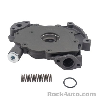

Looking at pics of the oil pumps, it almost looks like there's a relief spring nut on the outside of the pump, same side as the filter housing.

The oil pressure relief valve is built into the oil pump at the front of the crankshaft (behind the timing cover...). How many miles on your motor ? What weight oil are you using ? I'd recommend a 10w-30 or 10w-40 synthetic and Motorcraft oil filter. If you do the timing chains / cam phaser replacement work it's a good time to swap out the stock oil pump for a high volume one at that time.
Melling Oil Pumps at Rock Auto
Pressure relief spring is under that cap on the left side of the pump above ....
