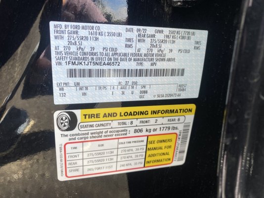

You’d be fine. The towing and payload numbers on these vehicles are extremely conservative and the expedition is about the best tow vehicle you can get. We’ve towed over both limits all across the continent.
