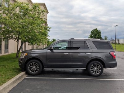

I coincidentally ended up with a 2019 Limited Expedition for my rental this week while traveling for work. A couple things stand out to me after the first day and 500+ miles.
  1. This thing feels like it is much better tuned and more powerful than my 2018. Do the 2019's have different tuning? The difference is NOT subtle.
  2. I'm assuming this has the CCD suspension because it is leaps and bounds better on the highway than my XLT. Super smooth and handles bumps much better. That's not to say my XLT is lacking here, I'm just surprised by how much better the Limited is.
  3. It is substantially quieter inside the cabin. In my XLT standing water or snow slush that is kicked up on the underside of the vehicle result in a metallic, tinny sound. Water kicked up underneath the Limited is much quieter. I'm going to have to investigate how they achieved better cabin isolation; interior vs exterior treatments.
  4. B&O sound system, while better than standard XLT, is very underwhelming.
I'm really curious about the tuning aspect. The engine and transmission both seem more responsive and in sync with one another. Power delivery is also much more robust and linear. I'm wondering if I should be talking to my dealer about lack of power or if this is simply the result of revised tuning between model years. I've been seriously contemplating a tune recently, but not fully comfortable with warranty implications given I paid for the extended warranty. That said, I grew up driving and tuning turbo cars and I'm not sure I can resist the urge. Especially when the results would (or should) be even better than the Limited I'm driving now.
Note that I do have bigger tires than stock which sap power. However, they were just put on this weekend, so my reference point is a bone stock 202A XLT.

that one you have does not have the ccd suspension .. only came with the 22 inch rims and those are 18s.interseting.. I have a limited with the 302a package...I hope that when I put on that readylift, it doesn't mess up my smoothe ride..

Thanks for the info. Really surprised it's not CCD. It's super comfortable on the highway and even around town. Might have to dig into the parts catalog to see if the shocks/struts are different between XLT and limited.
Edit: appears 4x4 XLT and non-CCD Limiteds share the same front and rear struts.

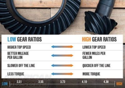

Also, @Deadman hit it with the 3.73s. Acceleration is much more noticeable with these gears so it’s going to feel way different than say 3.31s. Here’s a good reference chart I use to compare

I figured with a 10 speed it should already have a pretty serious overdrive, so I couldn't imagine buying one with 3.31's in it..... I kinda let the transmission overdrive handle the 3.73's mpg penalty and so far I'm very satisfied. I sure wouldn't want any lower numbered ratio. My neighbor has a F150 with 10 speed and Ecoboost 3.5 (he's not sure if he has 3.55's or what, but its NOT 3.73's) and we've compared the same hills and the same speeds with the cruise control on and his drops into 8th gear to climb the hills and mine usually stays in 10th, but at times drops to 9th. That alone will equate to a LOT less transmission wear over a lifetime on miles!
