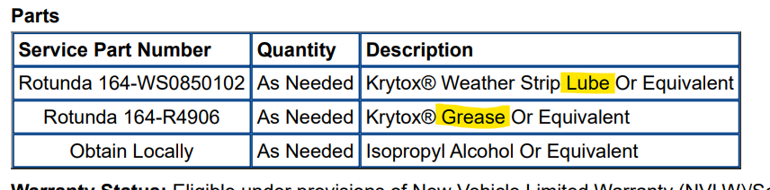

I would try the service bulletin yourself. And use the Krytox grease. My wife's first expedition made all kinds of racket when we got it. The dealer basically blew us off. After doing the bulletin we had no noise. It isn't hard so don't be afraid to try it. You can get the grease on Amazon.
https://static.nhtsa.gov/odi/tsbs/2019/MC-10169880-0001.pdf
The TSB mentions two different Krytox products - lube, and grease. You just mention the grease - did you get the lube too?
Edit: Wow, I'm struggling to find either product for sale up here. From what I can tell they've been replaced by Krytox GPL105 Oil, and GPL205 Grease.
https://www.krytox.com/en/-/media/files/krytox/grease-oil-lubrication-sunroof-systems.pdf
After doing more research, the two products in the TSB are in fact Krytox GPL105 Oil (lube), and Krytox GPL205 Grease (grease).
Also, the TSB was updated from 19-2374 to 20-2093 to account for the newer model year.
