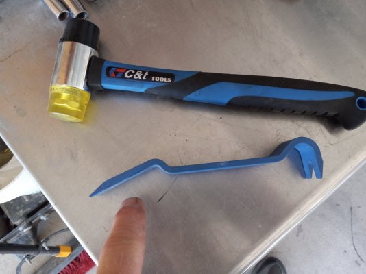

This just worked for me on my 05' Expedition rear side door. I REALLY appreciate this advice! My door had been stuck shut for 4 year since I got the truck. My child safety switch was at the half way point making not open from inside or out. I pulled the trim back, put on my headlamp light and could barely see the switch. I first took some tri-flow and barely bent the very tip so it could go in there and spray around the lock switch. Then I took the angled piece that come with the plastic trim tool kit(see pic, Im pointing at it) and it slides in there perfect. Then I just hit the top of the tool knocking the switch all the way down and the door opened. Now I need to fix why either of my rear doors open from the outside handle. But at least I can open the door and take off the panel in a proper way!
Thanks Expedition Forum!
