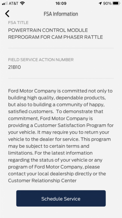

Showed up on my ford pass today. Anyone have info? POWERTRAIN CONTROL MODULE REPROGRAM FOR CAM PHASER RATTLE 21B10
My car does sound like **** when it starts up but the lease is up in 3 months so wasn't necessarily going to do anything about it. If this is an actual fix it may shift my plans.
This is not a “phaser recall”.
It is a customer satisfaction campaign by Ford, to reprogram the vehicles affected.
A recall is issued for safety concerns.
It showed up on ford pass under recall, but I could honestly care less about what it's called.
What aggie posted would make sense though if it's not letting the engine fire until oil pressure build a bit more to quiet the phasers. Was wondering how they could "solve" it with a reflash. Sounds more like treating the symptom and not the cause.

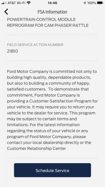

My FordPass has this alert as well.

I would hold off if I were you guys. Main reason, quite a few F150s who have had this done noticed engine/transmission shudders after the update was done. They claim the transmission shifts too soon and the engine bogs down and starts shuddering. You can read all about it here but it's a lengthy thread.

same here and got 11k free fordpass points for their ****** app issues for the past couple of weeks.

Yeah I have no rattling as of yet and zero shifting issues. Gotz no issues I’d like it to stay that way. I have the recall notification also. I’ll happily wait till this shakes out some.
