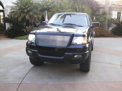

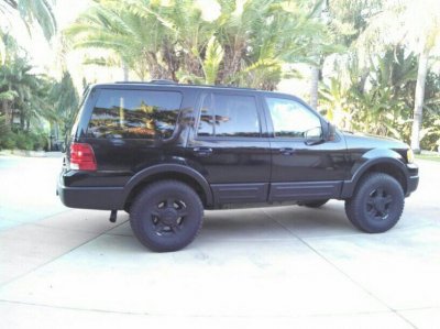

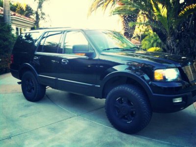

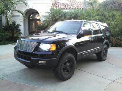

Finally got around to finishing the plastidip project. Took the lights off the roof. Swapped grills, dipped the trim, did the headlights and wheels.
A tip for the lights is 18 min in the oven at 250F. Then use a utility knife to cut the seal. Makes getting into them so much easier. Then reseal with outdoor silicon. Be generous and you'll have nice blacked headlight.
Took about 6 cans total for everything. Not a bad $40 investment.

ive heard as high as 350-400 degrees for 5-10 mins to open the lights...suppose to pull right apart

LOOKS GOOD, BUT......Who Balanced your wheels? why are the weights opposing each other like that? We have been doing tires 12+ years and I've never seen that, thats all

My tires have the same thing. I tried balancing them several times in high school, and they would not work any other way. I blamed the bigger tires.
I thought about going higher in temp, but I worried about smoking some of the coatings on the wires. Besides, 250 gets that headlight pretty hot to to touch. I wonder if 350 would have been easier.
Any reason you skipped the wheel weights?
I had smaller tires on their before and had dipped the wheels with the weights on it. Then after I got the larger tires, they put newer weights on that weren't the old dipped ones.
I'm planning on just touching them up in a few days.
I believe that just has to do with the larger tires. Not all of the silver marks you see are weights. Some of the silver marks are un-dipped parts of the wheel from where weights used to be.
