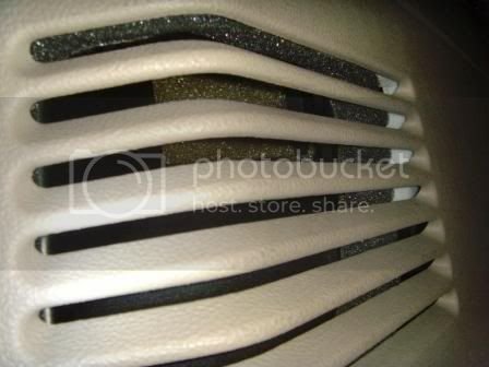

After snooping around with a flashlight, I think I found out what the culprit is. It's a little foam-looking door that when closed, allows the air flow to the roof vents, and when open, routes the air to the floor. I took pictures, though I dont know if they'll load up.
On the 03 Expedition, it's the big vent looking thing in the third row seating on the passenger side. If you sat in the third row seat, on the right most seat(looking forward), it would probably be by your right knee. If you look in there, you'll see the little square foam looking door.
The problem that I see is that upon opening, or closing , it doesnt stop. When fully open/closed, it continues to try to open/close, as if something isn't telling it stop. So basically the motor is "tripping." Eventually, it stops, especially if the AC is on full blast and the door is open(floor mode.)
Hopefully this helps? Id like to see if this is the problem with your vehicles. My dad wants to "open" it up tomorrow to see what's wrong. If we do( and maybe fix it) Ill post our findings.
BTW, I did this with full cold and full hot.

This is the little foam looking door when it's closed, letting the air go to the roof vents. The clicking noise comes when it continues to want to close. It closes, clicks, the door "flicks" back open little bit, then tries to close again.
This the door when it's open, diverting air to the floor. Does the same thing as when it is closed, except that it thumps instead of clicking(though it someimes does click.)
Do you guys know what Im talking about when I say the motor "trips"? I know there's something that does it (a toy motor?) but can't remember exactly what it is.
Hopefully this helps paint some sort of picture of what the problem maybe.

It stops momentarily because it goes from trying to close, to trying to open, and vice versa. Yesterday, when I took the pix, I cycled between floor and roof vents many times, both in hot and cold temp settings. Sometimes, it would stop when in floor mode after a minute or so of thumping. Ill try again tomorrow.
