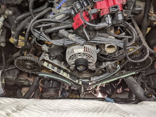

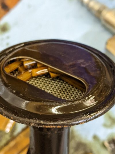

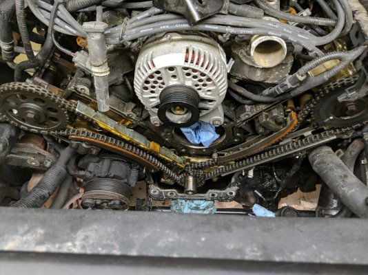

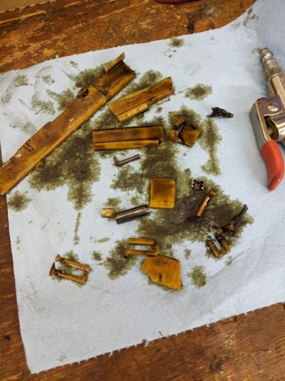

Ok, so I finally got around to tackling this job. It took me 4 days to get it done, which included dropping the oil pan. As it turns out, that part was an absolute necessity. The two stationary guides had completely lost the plastic liners, most of which had ended up on the oil pan and tons of debris in the pickup tube. Replaced the water pump and oil pump, along with all new timing set and high pressure power steering hose.
The shattered remnants of the old set.
This was in the pan...
Look at all that crap in the pickup tube!!!

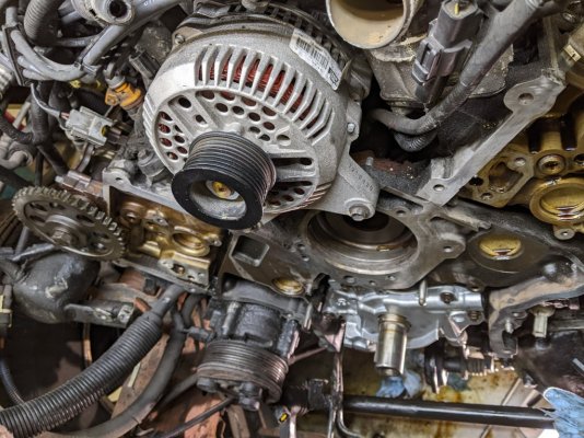

New oil pump before the timing gear goes in
PXL_20220702_181942167.jpgAll new duds...The timing was actually pretty straight forward.

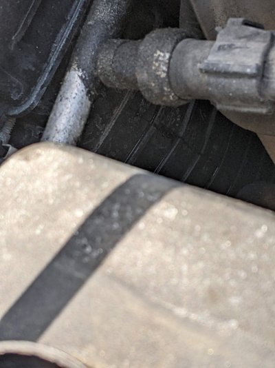

New radiator is in and no leaks. That lower hose connector is really odd. Let's hope that is the end of it's needs for awhile. We did remove the front driveshaft to track down a vibration issue. Looks like I'll need to get that balanced, but that's a topic for another thread.
