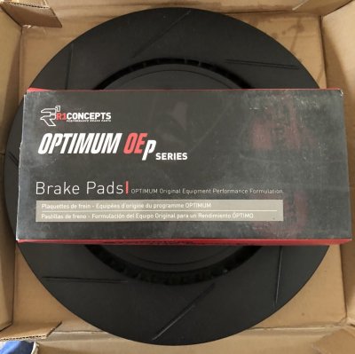

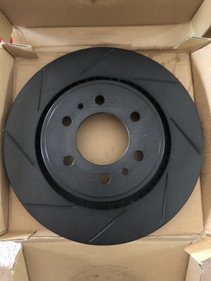

0B18592E-D6C6-4456-85F6-88FBB304228E.jpeg A7A55BE1-BC85-4737-AFD8-C134D0654FA9.jpeg Not sure if anyone else is familiar with them, but my new front brakes arrived today from R1. Got their black E-Line slotted rotors and Optimum OEP pads, as they were the highest friction pads they sell for the Expedition.
Obviously, I’ll be following up once I get them installed, but initial impressions are solid. The coating is uniform and over the entire rotor. No missed spots or areas where the coating appears to be off from the rest of it. Pads are pads, these do come with rubber-coated shims to eliminate noise, but otherwise they are fairly standard.
I have high hopes, they had a pretty good reputation on the F-150 board, and they’re the same brakes.

It looks like that rotor is installed on the wrong side.
The slots will tend to drive debris and water toward the center. Not good.

I actually discussed this with R1, and while they recommend the other direction typically, they also said it comes down to user preference. In my case, even with angled vents (which this rotor does not have) I would run my rotors this direction.
I’ve never seen hard evidence of any detrimental effects due to them being run this direction, but I don’t know everything, and if there’s something I’m missing please let me know where I can find the information so I’m aware for the future

I suppose if the internal cooling vanes are radial and not directional (angled), then the configuration of the surface slots is not super important, especially if they do not continue through to the rotor edge.
Why do you run them against recommended direction? Are they more quiet that way?

They aren’t more quiet, it stems from my track days, when running angled/curved vanes this direction as opposed to normal, it forces more air into the center of the rotor. A 3,700-pound car riding on 11-inch twin-piston brakes needed all the help I could give it in the cooling department.
