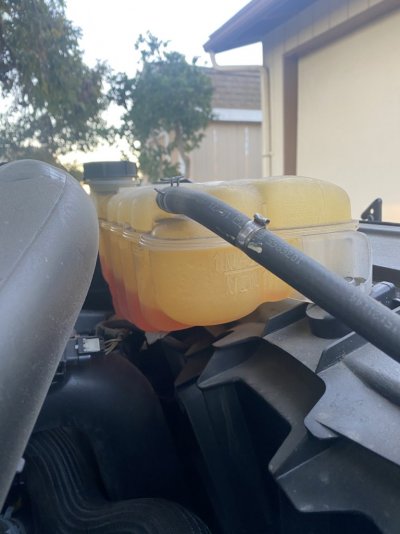

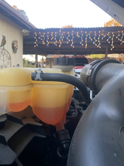

Thanks for the replies. Points of interest:
1. That’s my current coolant level and it does not go below that level.

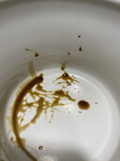

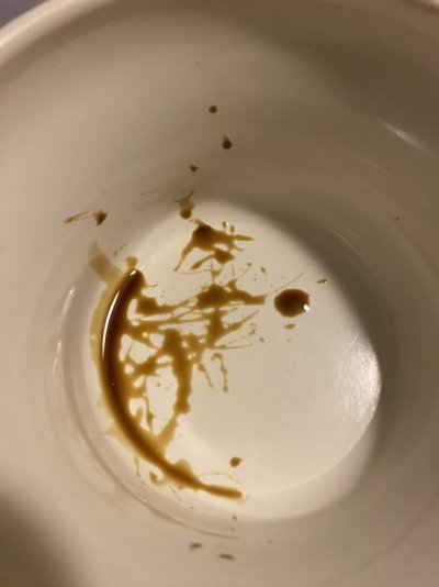

3. I can’t discern a change in oil color. Looks normal to me.

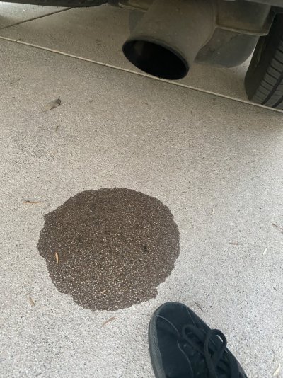

4. There are two 8 inch diameter wet marks under the vehicle. One presumably is from the AC and the other? Water pump as someone suggested, perhaps? Both were clear, not orange.
