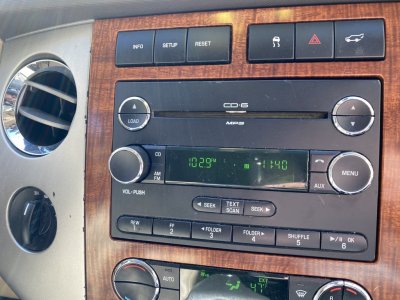

What’s up everyone.

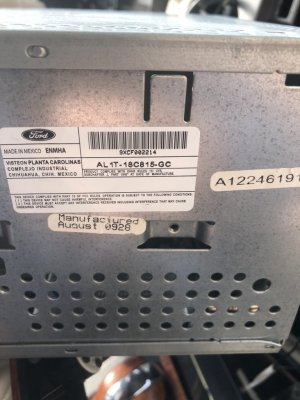

New to this forum but not new to expeditions. I’m on my second, had an 01 XLT and now have a 2010 EB. Long story short the radio display dimmed out completely on me. I tried a fix I found online but that didn’t work out. Made it worse actually. So I searched OEM units and found that there’s about 20 different part numbers. The one in my truck is AL1T-18C815-GC, but when searching that part I don’t find that model with Bluetooth. I even called Ford and ran my VIN and they gave me the same part # but they too said it’s not a Bluetooth model. So as it stands my head unit works but the only button that works on the dash is the volume knob. Every other button is shot. I can control it from the steering wheel or the rear console. I found someone selling the just the faceplate with the display board for cheap on eBay so I’m going to try and swap the boards and see if that works.
Has anyone done this successfully? I know the internal components of the head unit itself differ depending on what options are onboard but the faceplates all seem to have the same layout and interface, and I know for a fact that is what’s broken.

I can tell that it will physically fit, the ribbon connector is the same between the face plate and the main unit. It’s returnable as well. Even if it wasn’t I’m only out about $20. The plastic is cracked on it. So if it works I can just pull the circuit board off and use the the plastic front from mine.

It worked, $20 fix instead of paying a minimum of $300 for a refurbished unit.
