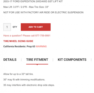

Looking for reviews from anyone who has a ReadyLIFT 3/2 set up, specifically on tire size recommendations. I would like to consider 34" tall, how much work is involved with "trimming modifications", as indicated by ReadLIFT's site below for 35".

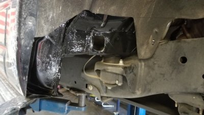

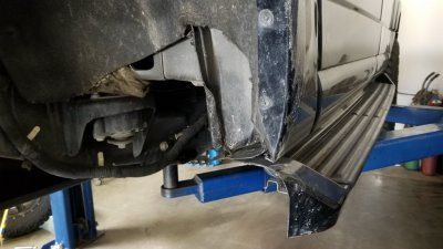

I finally found a shop willing to trim the inner fender. It cost me a couple hundred dollars but now I can run chains. I ran 0 offset wheels because I wanted to make sure I wasn't hitting any suspension components other critical components like brake lines. Here's a pic of what they did.
Inner liner - cut. Don't remove because wire looms are attached to it.
Side step - cut
Inner fender - pinch weld was cut off, welded then sealer applied. Driver side is partially done, passenger side has been cut & sealed.
This should prevent the rubbing I experience on dips while turning.
