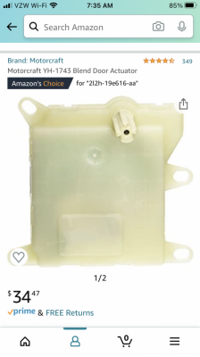

The rear HVAC has two of these. I simply replaced both instead of trying to figure out which one was clicking. Install videos can be found on YouTube.
2008COExpi
Apr 15, 2019
Colorado
Here is a link on how to replace. Ignore the years in the title, this worked for my 08 and should work for yours. Consider yourself lucky it wasn’t the front blend door actuator as that one is much more difficult :)

The blend door motors are one for temperature and one to switch between ceiling and floor. If the problem is no air as in no fan, those aren’t the issue.
