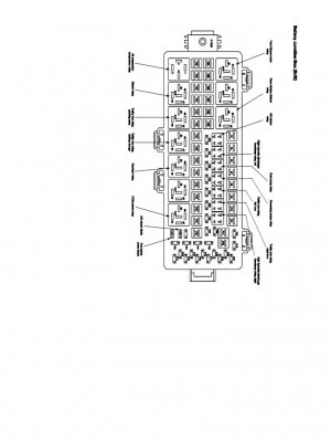

    I have a 3rd gen the compressor quit few days ago. Was told to replace the air suspension relay that looks like a heat sink module. Cant find the location of this part? I have check all fuses and relays all good and replaced to just confirm. Anyone know where this relay/module is located with the heat sink of it?
