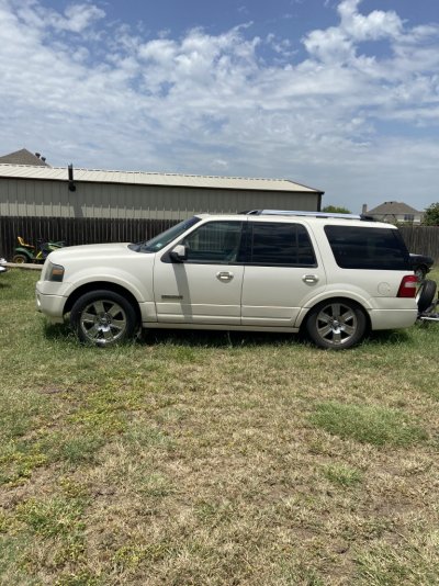

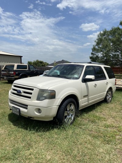

Hello all I have a 2008 Expedition limited with the air suspension. The rear sags when it’s parked. The first time it happened the compressor was bad. I changed it and it stayed up for a while. Then one day I came out and it looked like a mini truck in the rear. I started the car the compressor came on and it went back up. It rides perfect when I’m driving I can tow stuff and while I’m driving there compressor doesn’t come in at all. When it’s parked or I don’t drive it for a while it drops. I recently changed out all of the air lines and it still sags. Any suggestions?
