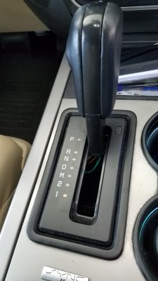

    So a thin piece of plastic that surrounds the console shift lever and moves indicating what gear you are in, cracked into a bunch of pieces and I have an opening down into the console with exposed lights and an indicator stuck in 1. I ordered the replacement part for $35 and was quoted $250 to install it. Oddly, it's not a replacement of the plastic piece that broke, but rather the entire shifting mechanism down in the console including indicator and lamps (less the lever). Has anyone ever opened the console to replace this and how complicated of a job is this? Or should I just suck it up and pay the dealer?

    Scott, I've had the console apart, and it's an easy job. Just find directions on the 'net or in a manual because the fasteners are hidden and the disassembly of all the plastic will stump you without guidance. There's a dozen screws and bolts. I didn't remove the shifter, but after taking apart the console it's all right there. Certainly worth a try.
    If the leather wrapped sides of the shifter lever have to come off, they are held on by spring plastic prongs that snap into the lever. Be gently prying them free without breaking the prongs. If you have to replace them, they're about $40 on ebay or at Tasca Ford. - Eddie

    20180531_214007.jpg Thanks Eddie. I found a thread under the 3rd generation directory that detailed the same problem and a related YT video for an F150 that was helpful. Basically, it was (1) remove the bezel around the shifter, (2) unscrew one screw underneath a pad in the tray at the front of the console and remove the top part of the console including cupholders (the armrest lid is not removed) and unplug the cupholder lamps, (3) remove the shifter lever sides, (4) unplug 2 wiring connectors for the shifter (tow/haul button and up/downshift rocker), unscrew two screws (don't drop/lose them), and then remove the shifter, and (5) unplug the shift indicator piece (shift indicator lamps) and remove the entire shift indicator piece. Install the replacement part and reverse the process. Oddly, step one took the longest as I couldn't get the 4th prong to pry loose from the console and I didn't want to break it; applied some WD-40 and it freed up. Took about 90 mins and just saved $250.
