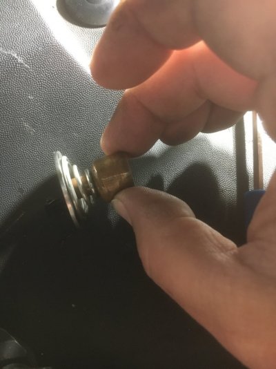

Jan 7, 2021
Ohio
Figured out the problem, half of an old thermostat had flipped over and fallen into the coolant passage under the thermostat and was blocking flow. Every time the thermostat opened the truck overheated, now it’s working fine.AB7B9682-4498-45B8-81C1-1D6CAAC5CCA8.jpeg
