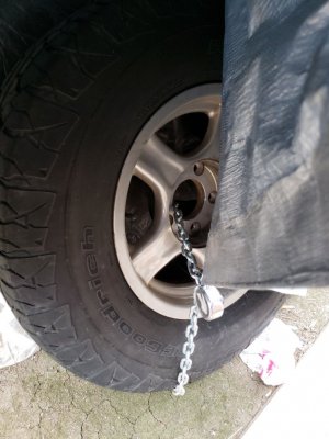

I bought a 1998 Eddie Bauer 5.4l, 2v, 4x4 for Father's Day 2017 for $1500 with 131K original miles (still had the original tires on it when I took it to MVD for Emissions ). It had been lightly driven 100 miles, 2 times a month or so for a few years. It came with the 255/70R16's that @josephpark18254 mentioned.
Still have them with the original rims (if you're interested), but immediately upgraded to 24" Black gloss polish (including 6" lip) with chrome accents. Improved MPG, ride, steering and they look amazing. (Check my profile pics). 26" is the biggest I'd go, but 24" seems to have enough rubber to ride smooth and not pop $250 - $400 tires on street curbs or potholes constantly IMO for the future. Until then you can roll the 16's I didn't like how the steering felt with them.
