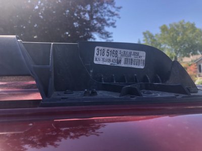

My wife managed to hit the roof rack in a parking garage on our 2015 Expedition causing damage.
Any suggestions on how to repair this? Is this a good opportunity to replace with something better aftermarket?

I just added the crossbars to my 2015 Expedition. That damaged part look like its just a simple cap missing. I popped that off when adding the new crossbars and popped it back in. Your old one is likely still on the floor of the parking garage. You may be able to just pop it in place. If not, you can get a used one and snap it in or glue it if the parts that secure it are damaged.
After that, aftermarket racks can look good or you can just get the ford replacement parts.

I was able to reattach the end caps, thought they were broken, but seems ok.
So now I only need to replace the cross bars. Are there any after market that are better then stock that attach to the factory base? Suppose I want to attach a bike rack or carry kayaks. Do these attachments attach do the factory rack, or are they typically mods that are retrofitted?

Aftermarket crossbars attached to the factory rack won't increase load capacity but can give you more real estate for mounting stuff simply because you can install wider bars. The factory bars will handle kayaks or bikes just fine, but there isn't enough width to mount them all at the same time.
As for an "overlanding" rack, you're going to replace all the factory stuff if you're going to do it right. Those setups weigh hundreds of pounds and need more than a few screws holding them to the roof. A simple basket will mount to the factory crossbars just fine, but an actual overlanding setup is its own thing.
Though you're welcome to take that route if just for the enjoyment of the spectators :)

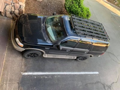

1100? K9 rack, right? Last time I checked it was like almost double that to cover the EL
