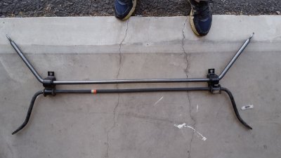

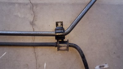

The hellwig is your best bet, it is a thicker bar than what is installed stock. They put those thin bars on to bias the vehicle for oversteer. I guess they figure better to spin out than understeer and hit what you're trying to avoid. I put an upgraded (steeda) rear sway bar on my focus hatchback and the body roll dramatically decreased and now has a more neutral feel in the corners. I'm thinking of adding the hellwig bar myself but it's down on my long list of upgrades at this point. The independant rear suspension adds to the body roll effect since it's tuned soft for comfort.

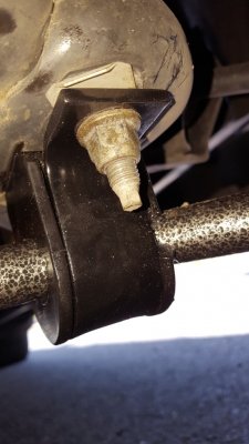

The bar should be easy to swap out, shouldn't even have to jack it up, probably just 6 bolts (2 each on th bushings and one on either side at the sway bar end link). Unless you have a hard time with the rear stabilizer bars, then a slight lift on the control arm would be needed.
