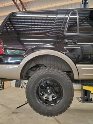

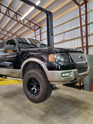

Original owner of this second generation 2004 Ford Expedition Eddie Bauer 4x4 with 171K miles.
Recently installed leveling kit with Fuel 17x9x12 rims and Mickey Thompson LT315/70R1735X12.50R17 tires. The above setup produced an overall 4" lift. Minor timing on lower front bumper to clear the stuffing of the MT rubber. Prior to lift overall ride height was 77" at the roof rack crossbars, now at 81".
EXPEDITION 04 LEVELING LIFT KIT FRONT 3" REAR 2" POLYURETHANE STRUT COIL SPACERS
http://www.ridetrendz.com/index.php...3-rear-2-polyurethane-strut-coil-spacers.html
View attachment 32601 View attachment 32602 View attachment 32603 View attachment 32604
what was the increase in ground clearance at the differentials?
