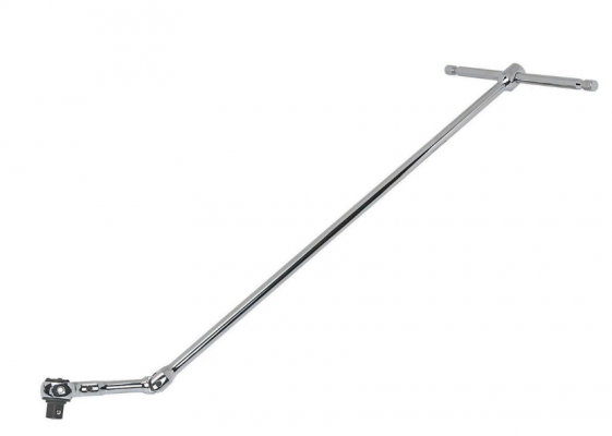

Plugs 3 and 4 can be quite difficult to get too. My first time changing plugs in my 5.4 2V it took me an embarrassing 8hrs. Second time 6hrs. 3rd time I found the $20 ratchet below at Harbor Freight and took less than 2hrs, the last time I did plugs it took 45 minutes. This ratchet makes all the difference in the world.
