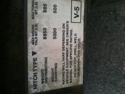

My question has to do with towing. I have to tow a 1996 Dodge Caravan from Southern California to the Bay Area (about 450 miles), and I was hoping to be able to tow back a 1986 Dodge Ramcharger 2wd.
I will be renting either a tow dolly or auto transport from uhaul and was wondering which way I should go? I understand that the tow dolly does not have brakes while the auto transport does but is quite a bit heavier.
I have a 1999 Expy EB 4X4 with a 5.4L. It has a tow hitch and what looks to be a 7 pin connector but I do not see an external tranny cooler. As a matter of fact I just had the radiator replaced a couple of weeks ago and the tranny lines are connected to the radiator.
I took a picture of sticker that is on the hitch.
Any suggestions will be much appreciated.

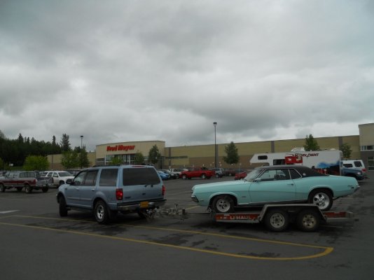

i'd say get the full trailer, thats what i did for towing our mercury cougar...5700lbs all said and done and it handled great!

Thanks for the replies. Thanks Panda, I looked through the bumper and saw 2 little coolers. Looks like a do have the tow package! I think I will go with the trailer as AlaskanExpy recommended. The brakes on the trailer will help out as well. I know I will not have a problem with the Caravan, I was just a little worried about the Ramcharger. It weighs about a little over 4,000lbs.
