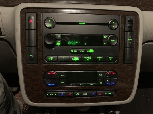

Before (notice that the labeling was peeling off the radio buttons making the car feel 'worn').
After, much cleaner look. I also got a USB port with /aux connector on Amazon to replace one of the Cigarette light ports. This was a better choice than having the new radio's USB ports dangling from under the dash. It even has an Aux port. But as I mentioned earlier, I ended up using that aux input on the radio for the back seat's DVD player.
