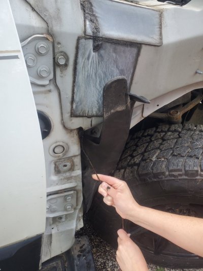

Just notice yesterday that my passenger carpet is wet. Don't have a sunroof and the rubber grommet is in place so now what should I look for?

Check the rubber accordion conduit between the door and the A pillar (by the door hinges). It is a press-fit into the A-pillar and door, and if dislodged, it can allow water to run inside the A-pillar and onto the carpet (behind the inside floor kick panel). Also check the conduit for rips / tears / cuts - it has numerous folds so you will have to examine each fold carefully.
Also check the body mounted rubber strip to ensure it is firmly seated on the body. The weather strip is a press-fit, and if loose, can be pulled off and squeezed with your fingers to tighten up the attachment point. If loose, or dislodged or torn, it can car allow water to run behind it, to the bottom of the body, then onto the floor carpet.
