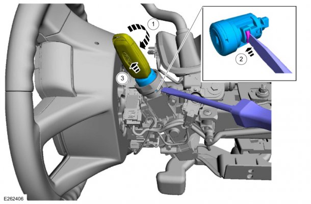

- Remove the steering column shrouds.
Refer to: Steering Column Shrouds (501-05 Interior Trim and Ornamentation, Removal and Installation). - Remove the ignition lock cylinder.
- Insert the ignition key and position the ignition lock cylinder to the ACC position.
- Using a screwdriver, press the ignition lock cylinder release pin through the access hole.
Use the General Equipment: Flat-Bladed Screwdriver - Pulling the ignition lock cylinder outward, remove the ignition lock cylinder.

- Install the ignition lock cylinder.
- Make sure the ignition lock cylinder is in the ACC position.
- Insert the ignition lock cylinder into the ignition lock cylinder housing located on the steering column. Make sure to align the locking pin with the locking pin access hole.
- Rotate the ignition key through all lock cylinder positions to check for correct operation
