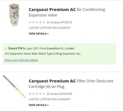

Thanks. It's been raining on/off the last two days and my in-laws' farm shop has been full of equipment so today is the first day I'll get a chance to look at it.
Can I get it evacuated even if I'm not ready to do the rest of the work? (Shop might be able to do it today but I can't get parts immediately).
Advance/Carquest has the compressor at 350-400! I'll check RockAuto.
Will I need to replace the expansion valve?
What is the desiccant cartridge? (see pic)
Since I have a front/rear system, I fear the level of complexity is beyond what I need to tackle.
Do I need to flush the lines if the compressor blew? Isn't there a chance that 'shrapnel' has gotten in my lines?
Sorry for all the questions but thanks for your time!

...and dang! I never thought about the rear...i see on Rock Auto there are expansion valves for the rear and front. Imma need that Haynes manual....(Or a lot from you guys). :)
The expansion valves aren't necessary bad since it was working fine before, if you had the orifice tube instead I would say yes for sure.. The dryer or accumulator (depending on which you have) should be replaced because they are cheap and have the desiccant in them which fills up and won't keep the refrigerant from getting dirty and wet (like a water logged sponge). I have doubts about evacuating it in advance because water is the biggest enemy of the system and condensation could build up plus it might not hold a vacuum that long...……..bad idea. I think they make a rear block off kit for this if you want to go that route. (easier maintenance, less refrigerant, etc.)

Thanks, Navi. I'll think on this a bit. Shop isn't open to evacuate anyway.
