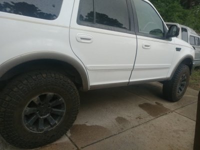

Hey Starkman, nice expy. I had a few questions about your lockers and gears, I have 33’s now, but in the future will be replacing with 35-38. I also pull a trailer and kinda daily drive. The Eaton’s you purchased don’t come with gears too, correct?? If not, what did you purchase? How do they work? Also what size tires do you run?
Starkman
Starkman
Apr 25, 2018
51
77
Arvada, CO
As I said above, 4.56 gears and I run 315/70-17 BFG ATs that are 34.5” diameter. They work great. 4.56 over geared, meaning with that tire size the speedometer shows a higher speed than I’m actually going. That ratio helps compensate for the bigger heavier tires.
