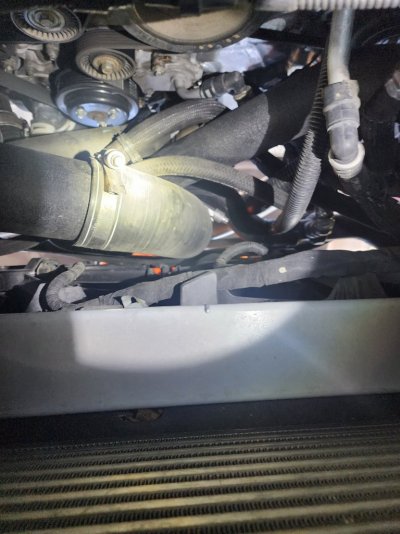

So my 2018 platinum 4x4 has done this a total of three times. Once over a year ago an twice within the last three months. I get home, park it and come back hours later (or overnight) and there is a puddle of coolant on ground. It seems to dump a certain amount and then it stops. I fill the reservoir and drive and the level stays constant until this thing happens again.
The puddle appears to be coming from the middle skid plate, maybe near the heat exchanger for transmission?? Never get a good look because of all the skid plates.
Anyone come across this before?

Could be cracked or leaking hoses going to the turbos or heater core. Doug you are going to need to temporarily remove those skid plates to find.
Professor you may have to remove the soft covers under the engine to find your leak.
Read this thread. Solution starts at post 6

Have you had the Shop do a pressure test yet? If it’s the fittings on the hoses that go into the radiator pressure test will show those instantly.
Good luck. Keep us informed

I had a leak in the coolant tube that connects to the driver's side turbo. Could be dripping down the turbo/exhaust and migrating from the actual source of the leak.

I didnt have time to look at that link yet, but I had a very similar issue with my 2018 Exp Max Limited.
Mechanic told me that it was a cooling pipe to the turbo leaking, there was a small crack in the pipe...the pipe is about $700 or so but the issue is that you basically need to pull the engine in order to replace this pipe as it is one contiguous y pipe that feeds both turbos from underneath the motor.
He suggested to sell the truck asap. To be honest I was looking to replace the vehicle anyway as I had about 60k miles and was having other issues with it. So that's what I did, he put sealant in the cooling system and I traded it in on a new 23 Exp Max Platinum leftover that I got a really good deal on.
