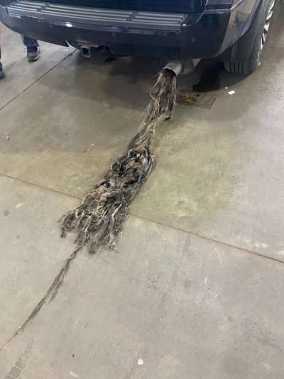

"stuff" out of exhaust

Sound packing from the resonator and/or muffler. Will have to be replaced.

Second time someone has posted about this here in the last couple weeks. :eek:

Had this happen to mine last year. You can't repack it. The resonator will have to replaced. I just had them put another stock resonator on it. If it goes again maybe I'll think of doing something different now that I'm outside the powertrain warranty.

Ha! My 16’ did that as well. I almost sh*t myself when I saw what looked like the chick from the ring coming out from under my car. I haven’t fixed it. Vehicle sounds a bit nicer in my opinion
