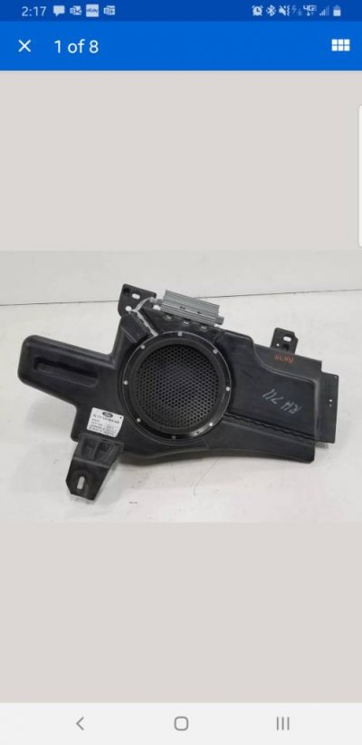

This is the factory enclosure, and there's definitely not enough room for two 6.5's. you'd be better off building your own that bolts to the factory mounts, but even then, I don't think you'd have enough box volume for two.c4a65e558ece12781482c3750c108e12.jpg

That don't look like a factory box for a 01' Expedition. I should have put that in lol

Sorry, I went straight to 3rd gen box on you there.

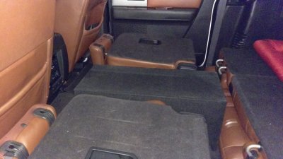

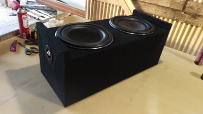

There is always a way. My vehicle is a 2011 King Ranch EL, but something similar could probably be done for yours. I made it from scratch. The box works as a center console with the seats up, and fills the gap between the seats when hauling cargo. That's a down-firing pair of 10s, isolated from each other. Each compartment provides 1.1 Cu Ft of volume, which is what the woofer manufacturer called for.
