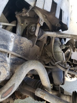

So I want to lift my 1999 EB. But it has air ride. I already ordered the 6" lift from fabtech only to find out it won't work. Does any one know exactly what the difference is? As far as I can tell is that the top air shock support is taller and the torsion bars don't have enough torsion to keep the vehicle up in the air without the air shock. I'm pretty sure the rear springs that come with the kit will just fit in place of the air bags. But not positive. I can cut and weld a little, so if it can be done I want to try. Any insight would be helpful.
Thanks
