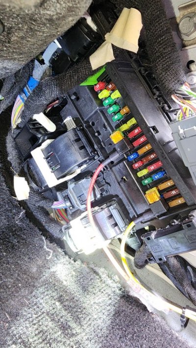

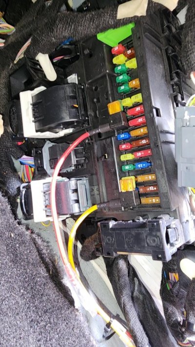

Sorry to mislead you in my previous response. I reversed the numbers. The yellow wire (fuse 37) is the accessory power(switched) and the red (fuse30) is constant power. I tried all functions with camera rolling, everything works as intended.20240725_165149.jpeg20240725_165033.jpeg20240725_153427.jpeg

You are right , was my mistake fuse 37 is ACC power. I just tried heated steering wheel this morning and everything seems to be working fine. Again, on 2019 platinum with Rove camera and installation kit
