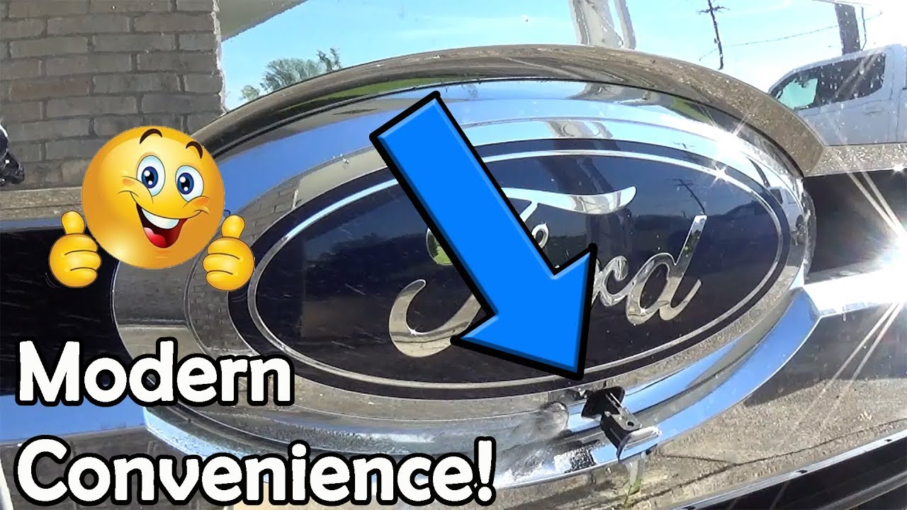

I have a 4th Gen and it has a washer jet in the Ford emblem for the front camera and the line for it is right behind the grill where the frozen washer fluid is. I wonder if they did away with them in the later cars since I have a 2018 but the line is still there and leaking or was plugged and the plug came dislodged?

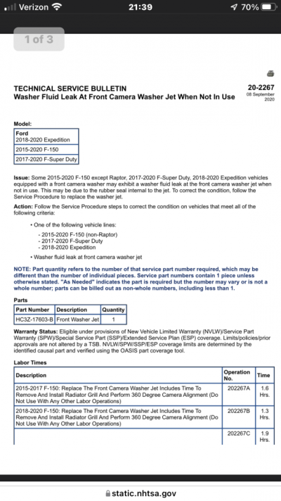

Anyone have a part or drawing showing a front camera washer exit?
You do not have the washer. Those that have it, it is clearly visible.
Again, I ask, what was replaced that you said was leaking?
